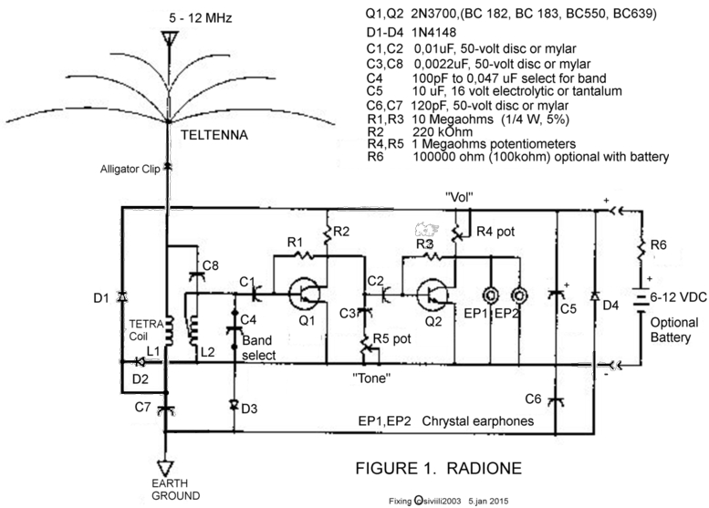

To understand how the Radione works, take a look at Figure 1, the schematic. You will probably be initially impressed with how simple the short-wave receiver circuit is. The most unusual feature of the Radione is the TELTENNA. While the TELTENNA can be as simple as a ten foot length of hook-up wire, ideally it will actually be a large metal object. In most cases, the larger the metal object, the better the reception! I personally like to use my file cabinet, but you should fed free to use your car, the bed-springs, some pie pans, or a long-wire antenna.
The TELTENNA functions by collecting electromagnetic energy radiated by distant transmitters, as well as local radio/television stations, satellite systems, telephones, your computer, and even the house wiring itself. Notice that the TELTENNA is connected directly to the outer portion of the Tetra Coil, called LI. In series with L1 is a l2OpF capacitor C7 which forms a series resonate circuit and serves us by isolating the electrical signals in the TELTENNA/L1 path from Earth ground. Electromagnetic signals received by the TELTENNA will range in frequency from a few Hertz to Mega Hertz (MHz).
These received signals are useful for two reasons: First, we wish to receive and listen to signals that oscillate from 500,000 cycles per second up to about 12,000,000 cycles per second. Within this portion of the electromagnetic spectrum, countries all over the world communicate one another using voice, Morse Code, facsimile, radio teletype, etc. Second, the Radione needs all of the electrical energy it can absorb to help power the active conversion process Because your Radione is so thirsty for power the larger the TELTENNA, the more and better reception you will enjoy.
To convert the "free-air" electromagnetic energy into useful electrical power, diodes D1 through D4 form a simple bridge rectifier. As high and low frequency signals appear across C7, they are depolarized and applied to the virtual positive and. negative supply points on the Radione. Capacitor C5 filters and smoothes the ripple and sudden surges in the incoming RF (Radio Frequency) signal. Amazingly, your Radione can synthesize its own DC power source up to as high as six volts, right out of thin air! Although the current is limited, there is more than enough to power many practical devices (calculators, radios, etc). This is the essence of Tesla's radio. Free energy for all to enjoy!

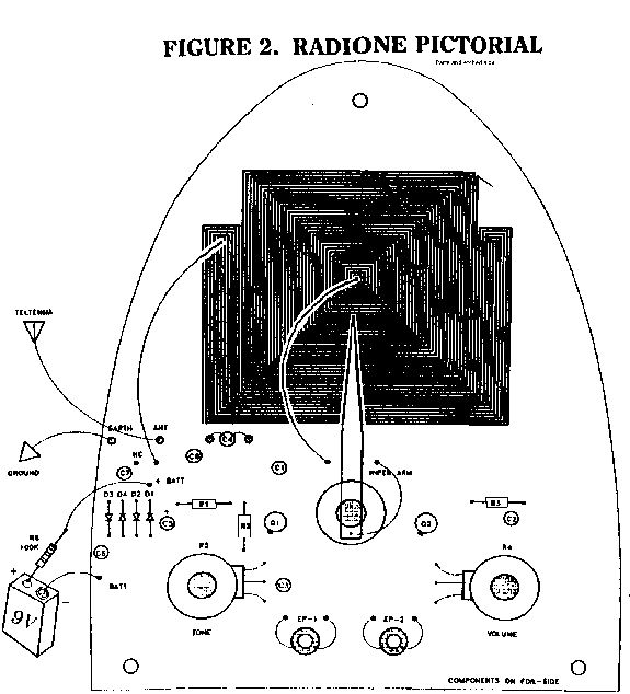

Next, notice from the printed circuit board artwork provided with the project, that the Tetra Coil is formed from a basic geometric pattern. Essentially a folded-coil within a coil, the Tetra Coil selectively couples energy. from the L1 section to the tuned L2 section. When capacitor C4, the Band Select capacitor, is installed on the Radione front panel, it tunes the L2/C4 circuit to resonate at a specific frequency in the range from .5-12 MHz.
By placing a wiper arm in direct contact with the L2 section of the Tetra Coil, we are free to vary the inductance of L2, and consequently, the I received frequency. This RF tuned signal is coupled into the base of Q1 through coupling capacitor C1. Notice in Figure 1 that Q1 is very lightly biased by R1, a 10 meg resistor. Notice also that R2, Q1's collector resistor, is a very high value. This limits the amount of operating current available to Q1, and keeps the device from loading the low-current supply line. As tuned RF signals are amplified by Q1's NPN crystalline structure, they are detected and rectified to yield their base-board AC audio component.
Capacitor C3 and TONE control potentiometer R5 allow the operator to adjust the spectral content of the audio. I like to run my Radione wide open, but you may want to roll-off the high frequency response for more comfort able listening.
Audio signals are next coupled to the base transistor Q2, the audio amplifier. You will notice that Q2 is biased in the same fashion as Q1, with the exception that a 1 meg VOLUME potentiometer replaces a 220k collector resistor. Believe it or not, a VOLUME control is an important feature on your Radione. Late at night, when the skip is right, those distant stations will swamp the crystal earphones EP1 and EP2!
I say crystal earphone here for a reason. Don't try to use low-impedance earphones from your Sony Walkman or similar radio because they wont work. EP1 and EP2 must be of the crystal type.
While you can get by with only one earphone, one for each ear really makes a big difference. The fidelity of my Radione is astonishing. The phase-changes induced in the late-night sky wave do a great Dolby Surround Sound number!
You can t find anything suitable to use for a TELTENNA, you can connect a 9 volt battery through a 100k resistor, R6, to provide power. (I would venture to guess that a battery would probably operate your Radione continuously for over a year.)
Well, that's it for the theory. Now that we are ready to put Tesla's concepts to work, let's make him envious by using the most modern construction techniques we can muster!
RADIONE CONSTRUCTION
While it may be possible to hack together a Radione, I suspect that your results will be very disappointing. Instead, take the guess-work out of the project by carefully fabricating a printed circuit from the full-size artwork provided. While any standard fabrication method can be made to work, pay close attention to the geometric detail in the Tetra Coil. THE TETRA COIL MUST BE PERFECT FOR YOUR RADIONE TO WORK PROPERLY! If your PC board fabrication technique is lacking, consider obtaining a pre-etched/predrilled, ready-to-wire PC board from the source listed in the Parts List. Even the slightest micro-fracture or void in the coil traces will seriously affect your Radione's performance. Additionally, the aspect ratio of trace width to bare board will affect the overall performance of the Tetra Coil.
Notice that many of the pads/holes on the Radione PC board artwork DON'T GET DRILLED! Most of the components mount from the foil-side of the card so don't get drill happy. Remember to take your time and work slowly and carefully. Your finished Radione will only look as good as your finished PC board. You can use a small keyhole or hacksaw to cut the outside dimensions of the PC board and finish it with a flat file. Again, work slowly and carefully to avoid damaging the card.
Next, begin mounting the various components as indicated in Figure 2, the pictorial diagram. Because the various resistors and capacitors are mounted on the foil-side of the card, you will need to pre-cut the lead lengths and top-solder them into place. Watch for solder bridges and cold solder joints when working from the foil-side. Short lengths of wire can be used to connect the potentiometer leads to the PC board.
With the Resistors and Capacitors in place, carefully mount the transistors Q1 and Q2 next. The leads should be about 1/8" long and properly oriented as indicated in Figure 2.
The Band Capacitor, Antenna, and Earth connectors are push-through types that solder directly to the PC board. Be careful when soldering the connectors in place, in that too much solder will quickly fill the center of the connectors and damage them. Test the connectors by pushing several Band Capacitors into place from the front side of the PC board.
Using small hook-up or wire-wrap wire, configure the Tetra Coil leads as indicated in Figures 1 and 2. Be sure to use neat point-to-point techniques that keep the coil wires above the Tetra Coil itself, and out of the way of the Tetra Coil Wiper Arm.
To construct the Wiper Arm, carefully remove the back cover of a suitable potentiometer. I used a standard 1 meg unit, exactly like R4 or R5. Using a pair of long-nose pliers, simply fold the holding tabs back out of the way and pull the back cover away from the main body of the pot. Next, set the pot mechanism aside and cut out the brass or copper Wiper Arm contact as detailed in Figure 2. Be sure to place a small upward curl at the end of the Wiper Arm that contacts the Tetra Coil. This will let the Wiper Arm slide smoothly across the foil traces of the Tetra Coil without excessively wearing them in the process.
Using five minute epoxy or super glue, carefully mount the Wiper Arm on the rotating disc of the pot mechanism. Double-check your work frequently to make sure that none of the glue has dripped down near the shaft. Wipe off any excess glue immediately or you won't end up with an adjustable coil! Finish up the control by soldering the Wiper Arm contact wire to the Wiper Arm as indicated in Figure 2. As a last detail, you should glue a left and right arm-stop peg on the foil-side of the PC board. These stops can be made from nylon spacers, small wooden dowels, or about any small non-conducting object. The stops serve us by preventing the Tetra Coil Wiper Arm from moving too far across the L2 portion of the coil and shorting to the L1 side. While this action wouldn't really cause any problems, it can cause an annoying click in the earphones.
Three old-time-type wooden dowels should be used as standing spacers for your Radione. Because you will want your Tesla Radio to look as authentic as possible, use small #4 wood screws and glue to mount the three legs on the foil side of the PC board. These legs will let you operate your Radione either standing up or sitting down flatly on a table.
To finish assembling your Radione, solder a 20 foot length of #22 (or smaller) RED hook-up wire to the pad marked ANT (Antenna). In a similar fashion, solder a second 20 foot length of BLACK wire to the pad marked GND (Ground). I like to put a large alligator clip on the end of each wire to make it easier to attach to metal TELTENNA objects.
When not in use, the ANT and GND wires can be wrapped around the three dowel spacers legs. If you wish to connect a longer TELTENNA or Earth wire to your Radione, simply connect it to the unit via the front panel push-pin connectors.

[url=http://postimage.org/][img]http://s22.postimg.org/gpcj4jls1/radione3.jpg[/img][/url]

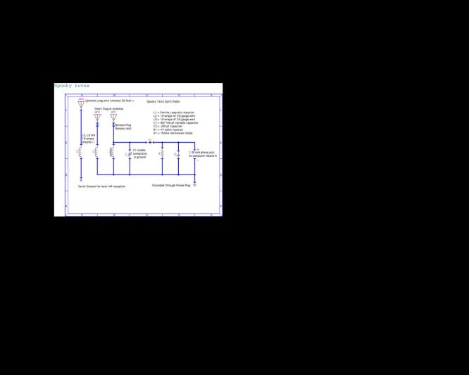

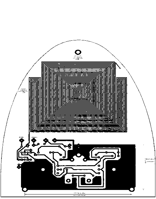

Kuva lisää, kytkiskaavio
Fixailin luettavampaan kuntoon
Re: DIY: Tesla Spirit Radio?
ViestiKirjoittaja siviili2003 » 06.01.2015 14:20
Tämä kuva lisää ja YVllä voin lähettää tarvitsijoille autocadillä piirtämäni piirilevyjen valotusmaskit, kunhan olen viimeistellyt ne (hirmu urakka on huh huh että saa siistin) ne on sitten tosin muotoa DWG, joten BMP muunnos voi olla haastavaa ellei jussi osaa auttaa....
Tämä voi olla useimmille meistä se ensimmäinen OIKEA vapaaenergia tee se itse projekti jolla voit todistaa tutuillesi että vapaa-energia on todellisuutta, kun sulla on toimiva radio joka toimii ilman ulkoista virtalähdettä! :o
Komponentti sijoittelut piirilevylle

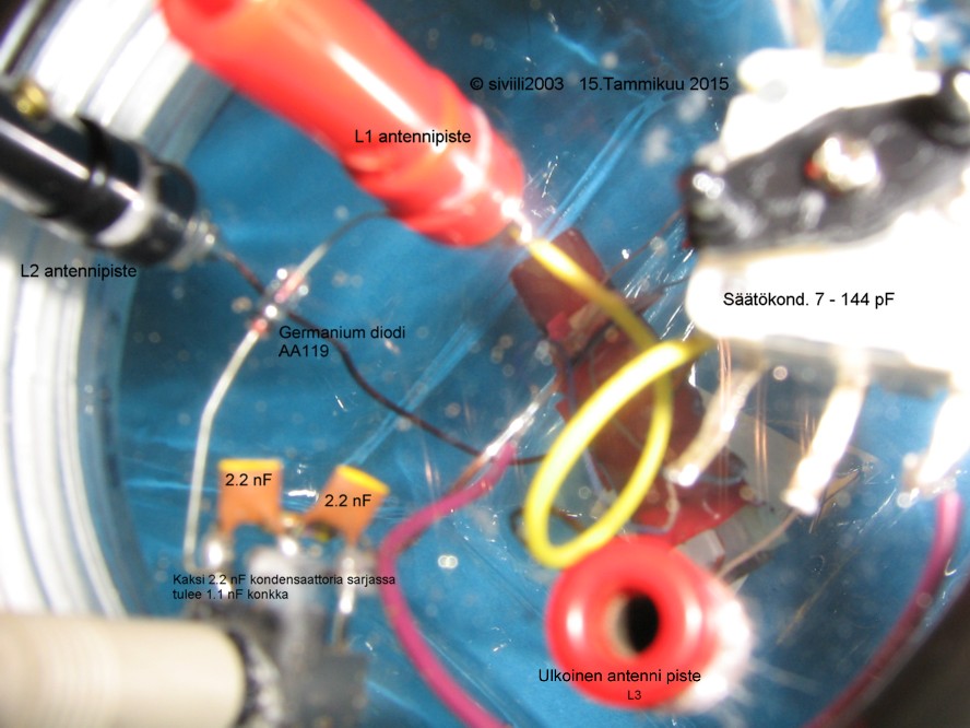

Tästä kuvasta on siis kyse
ViestiKirjoittaja siviili2003 » 15.01.2015 21:58

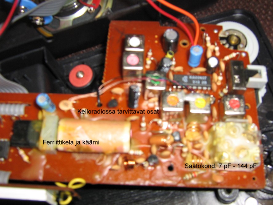

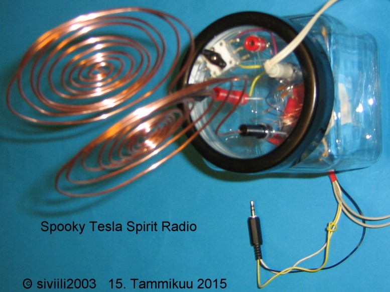

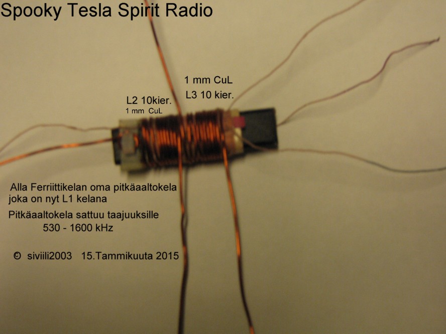

Niinpä siis minäkin väsäsin tänä iltana Spookyn spirit radion, käytin germaniumdiodi AA119, kun ei muuta ollut, hei mitäpä spektrianalyysi ohjelmaa suosittelette tämän kanssa käytettäväksi?
Ennenvanhaan oli Windows 95/98/NT koneille erinomainen Spectrogram ohjelmisto, onko vastaavaa yksinkertaista ohjelmaa Windows XP:lle tai Windows 7:lle?
Mistäs kohdasta windows mediaplayerista löytyy äänikortin sisääntulosingaalin otto?
Vanhasta Kelloradiosta löytyikin osat tähän projektiin, säätökondensaattori ja Ferriittiantenni kela
